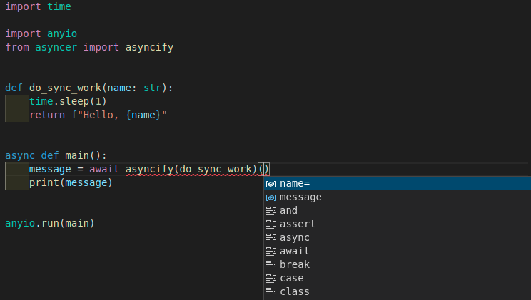

  • Autocompletion for function arguments:

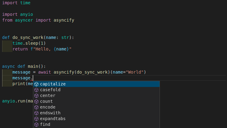

  • Autocompletion for return values:
